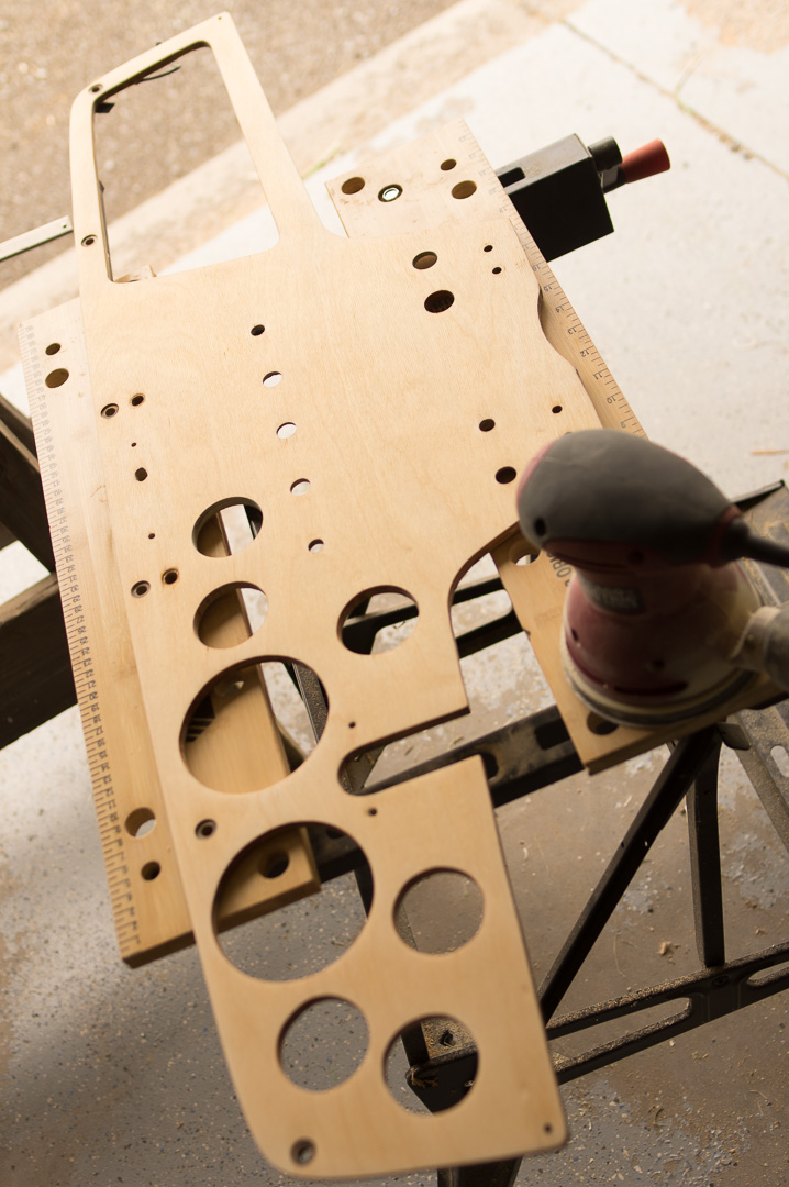

My S2's had a marine plywood dash for probably over 30 years now and it's held up well. It was originally just stained a blonde color. In my current disassembly, I removed the dash and sanded and re-stained it (then had someone else do it since I did a lousy job!) - color-wise, it's now darker and closer to the original color but at the point where if it's sanded any more, it'll need replacing (or veneering or something - I know very little about wood finishing.)
This is what it looked like after sanding, before staining. Note that it's sitting on a Ron Hickman-designed B&D Workmate.
